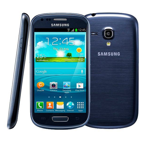

Çözüldü Samsung Galaxy S3 Mini (GT-I8190) BOOT Repair [Medusa Pro] (1 Viewer)
whyler
As Teknik Elektronik
[HIDETHANKS]JTAG SONRASI STOCK ROM YUKLENECEK[/HIDETHANKS][HIDETHANKS][/hidethanks]

Repairing from file "C:/Program Files (x86)/Medusa Pro Software/firmwareFolder/SAMSUNG_GT-I8190_EMMC.srf".
Write data verification is disabled.
Writing MBR,GPT partition... Done.
Writing MasterTOC partition... Done.
Writing PIT partition... Done.
Writing MD5HDR partition... Done.
Writing STEboot1 partition... Done.
Writing STEboot2 partition... Done.
Writing Dnt partition... Done.
Writing reserved partition... Done.
Writing EFS partition... Done.
Writing IPL Modem partition... Done.
Writing Modem partition... Done.
Writing Loke4 partition... Done.
Writing 2ndLoke4 partition... Done.
Writing PARAM partition... Done.
Smart Repair is successfully complete.
SW: 1.5.0; FW: 1.22.
Disconnected.
s3 mini pinout.jpg[/HIDETHANKS]
